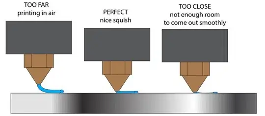

Keeping the print bed clean as mention in other answers is key. Dish soap (without any additives) and water to wash away oils from your hands the printer itself is the first step. Isopropyl Alcohol (IPA) is also good to keep the bed clean between prints, but when you run into adhesion problems, wash with soap first. IPA in many cases just move the oils around the bed instead of removing them. Also, always wipe from the centre of your bed to the outside.
The next step is to also ensure the bed is level (unless you have auto-levelling). If the bed is level, then you need to make sure your z-offset is correct. The first layer must be printed with the nozzle low enough to press the first layer into an oval shape onto the bed so that the surface area in contact with the bed is increased. If the z-offset is too high the first layer filament is going to have a round shape which means the printer is basically printing in the air.
Be careful not to decrease the z-offset too drastically because the nozzle should never come in contact with the bed because damage to the bed, nozzle or heat-break is possible.
enter image description here Image source
