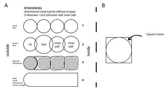

A) Optimization from equal flow to full true dimensional prints B) visualization of cross section for square corners
Probably the best fill up will be reached by printing the second outer wall after the outer and inner walls as it wouldn't go under the 1st walls cavity on its own.
Image (Simplified cross section of a single layer and its printed geometry):
  • A1: Print with all the same flowrate, each line is printed with the nozzles diameter (Danger of delamination)
  • A2: Print with 3 different flowrates. 1st outer wall with nozzle-sized lines. 2nd outer wall with highest flow to fill cavities under 1st OW and to fill up corners (air gaps), inner walls with medium flow to fill corners
  • A3: ideal flow into corners and cavities
  • A4: perfect result to aim for

    Deposition of filament is not according to the sketched image under 1. A printer should never deposit round lines, they are pressed down, so you get more flattened lines. The question on underextrusion is a valid question. – 0scar Feb 28 '21 at 14:55
  • Thx, you are absolutely correct. I forget to mention the image is highly simplified to keep the eye on the main question/problem i want to address. I think the point of "the second outer wall is actually requiring more flow than the very outer and the other inner walls" is still valid thus the question if someone tried it out etc. – constant-flow Feb 28 '21 at 17:56
