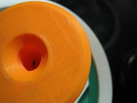

If I start printing in the morning a print that takes 2 hours to print -- in a cold garage, cold filament, cold tube, I end up with a solid first 4 layers and lacy last 4 layers. The last 4 layer are so thin that they end up to be almost see through.
last layer last layer
first layer first layer

I don't think your temperature based explanation makes sense. This looks to me just like a first layer smashed against the bed, possibly too much due to nozzle being too low, followed by underextrusion when there's actually the right amount of space to extrude into. If you have fewer than 3 top layers or less than 0.6 mm of top layer thickness, you will almost certainly have an underextruded top like this just from the first top layer sagging into the space between the infill lines. Since the walls look okay, this is my best guess; if the walls looked bad too I would suspect poorly tuned filament diameter/E-steps-per-mm. Also check that your infill is not too sparse; more than 4 mm or so between infill lines gives a lot of room for top layers to sag into and may increase the number of top layers you need.
I see you added in the comments that your layer height is 0.1 mm. At such thin layers, you probably need at least 5 or 6 top layers; the first 2-3 are expected to sag and not fill the space.
  • My infill was set to 12%, about 8 mm apart. The top layer was set to 4 layers. Your answer points to under-extrusion -- which is clearly what I had do to having set the 1.75 mm diameter filament to a diameter of 1.90 mm in Cura. So I guess it is not a heating issues after all. That is very helpful! – MeSo2 Feb 20 '21 at 04:35
    I'd try setting infill line distance to at most 5 or 6 mm, possibly using Cura's gradual infill feature if you want to save material on lower layers, and increasing the top layers to 6. I suspect that will get you acceptable results. – R.. GitHub STOP HELPING ICE Feb 20 '21 at 05:15
    And also fix your incorrect filament diameter. I just read your comment where you mentioned it (1.90 - that's a HUGE factor off because it scales quadratically) and that alone could explain the problem; you might even be able to stick with sparse infill and only 4 top layers. – R.. GitHub STOP HELPING ICE Feb 20 '21 at 05:17
