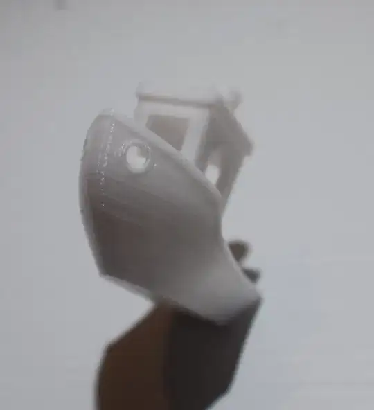

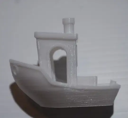

The printer I am using is an Artillery Sidewinder X1. In the photos attached you can see that I am having a lot of inconsistency between layers. The problem has never gone away and I always thought it was Z wobble but now I'm not so sure it is because we have tightened everything up, making sure everything is stable and tight. Is this Z wobble or is it something else. Could it be the filament? Does it have anything to do with the slicer settings?

    that marks are due heating problem vs quality filament vs speed printing. I had the same few years ago. – Fernando Baltazar Dec 09 '20 at 01:17
  • Thanks for putting me on the right track. I will look into those three things and post an answer if I fix it. – Artichoke Dec 09 '20 at 19:35
  • For me this also look like overextrusion and heat- notice the drops in the middle of boardside's lower part. Also, corners (booth, bow) seems emphasized - and if it's not filament (too much + too hot = pressure) then maybe too little jerk? – octopus8 Feb 06 '21 at 23:59
No, this is not Z-wobble, Z-wobble is usually characterized by a repetitive distortion, from the supplied images this repetitive pattern is not observed. A Z-wobble pattern is typically caused by the lead screws, or the Z drive where carriage follows the X/Y motion of the lead screw nut.

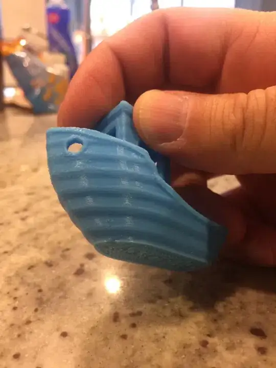

A typical image of Z-wobble on a Benchy would look like:
Your print doesn't look that bad for a low-end 3D printer.
