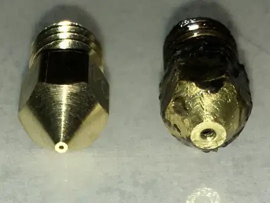

I had a new Extruder tip on my Ender 3 3D printer. the tip looked like the left tip in the below image. After I have been using it for about 5 months, the tip got dull/flat, like the tip on the right in the below image.

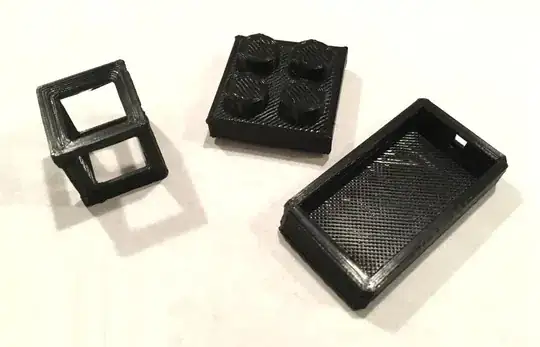

Image of my 3D prints using my PLA filament enter image description here
Image of my PLA filament enter image description here

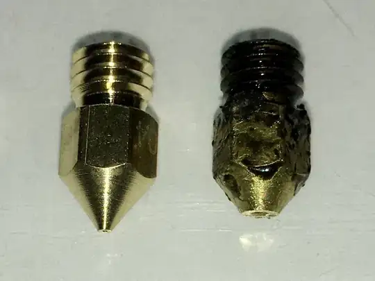

Actual Images: (Sorry for all the edits, I’m trying to add the images on my phone and it’s not working) enter image description here

  • I realize the pictures are only illustrations emphasizing the kind of change you see, but since a change that severe isn't plausible, it would be helpful to see photos or some sort of measurement of the actual change you're experiencing. How many nozzles has this happened to? Are you sure you didn't just get differently shaped ones to begin with (there are at least 2 common versions with same orifice diameter but different tip shape). – R.. GitHub STOP HELPING ICE Nov 15 '20 at 07:32
  • @R..GitHubSTOPHELPINGICE it's feasible: that's about 1 mm, and [0.6 kg of Carbonfiber filled filament do about that to a printer nozzle.](https://olssonruby.com/design-quality/) – Trish Nov 15 '20 at 20:01
  • @Trish: wow, is that from combing over the already printed material? – R.. GitHub STOP HELPING ICE Nov 15 '20 at 20:36
  • @R..GitHubSTOPHELPINGICE it's from printing carbonfiber filled PLA (worst offender in being abrasive) alone. They used a circle or cylinder as a test shape, so the ground is somewhat even. – Trish Nov 15 '20 at 20:42

    That's *extremely* atypical. I printed about 10 spools or such on my current nozzle and lost not any brass. Could you show a picture of a print and/or a piece of filament? – Trish Nov 16 '20 at 23:53
    Ok, the new pictures stun me... that is the result of that very sort of filament only? No woodfill or other filled filament, no glow in the dark, nothing ever? – Trish Nov 17 '20 at 00:43
  • Nope. Just plain ordinary PLA. @Trish – X Builder Nov 17 '20 at 02:49
