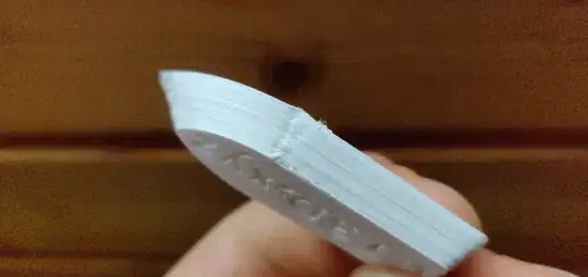

First of all, I'm quite new to 3D printing. After printing some temperature towers, stringing and bridging tests, I wanted to print the Bechys to see everything working together. I'm getting some strange "bumps" in the outer walls. It looks like for 2-3 layers, the filament gets lifted up.

Update: I started the print again with aligned seams. Now you can clearly see the artifact. At the point of the seam the print is warped inwards and upwards.
aligned seams
I did some more prints and tried to increase retraction distance up to 10 mm and retraction speed up to 60 mm/s, but I also did not manage to improve the print. I also tried to enable the "retract at layer change" option and to disable "Z Hop When Retracted" but without success.
I set the travel speed down to 45 mm/s with no change in print quality.

  • Please slice with layer change aligned and post an image (20 layers should suffice), so that we can see if this is related to layer changes or not. – Davo Jun 18 '20 at 16:37
    Hi welcome to 3DPrinting.SE! What can be seen on the bottom photo is that your nozzle is a little too far from the bed, and you aren't using enough part cooling (see the overhanging bow). – 0scar Jun 18 '20 at 22:00
  • @0scar I am aware of the part cooling but it already sits at a 100 %. I think I will do an upgrade shortly. I have already done a temperature tower, bridging and stringing tests. The benchy was just to see everything together. How did you determine, the bed being to far away from the nozzle? – mrei Jun 19 '20 at 07:11
    If the fan is already at 100 %, then you print too hot or the cooling fan doesn't provide enough flow, many print fan ducts constrict airflow, we cannot see what you are using. Your first layer doesn't look that well, there are many channels, but it is hard to tell from the photo. Sometimes 200 °C is just too hot, most PLA can be printed from 185 °C. The last photo looks as if the nozzle has overpressure at the end of the outer wall or oozed out filament at the start of the outer wall.This could be a retraction issue. – 0scar Jun 19 '20 at 08:01
  • Thanks for the help so far. I'm going to play around with the retraction again and see if that helps. – mrei Jun 19 '20 at 10:47
  • Over the course of a few testprints I increased the retraction distance and speed. Unfortunately the outcome is exactly the same. Could the printer feed to much filament or would I notice that otherwise? Are there other retraction parameters that could cause this issue? – mrei Jun 19 '20 at 13:25
  • Nice results (not pretty, but helpful). Please try slowing down your non-printing moves to the same speed as your printing moves, and let us know if this helps. ;) – Davo Jun 19 '20 at 16:21
  • Unfortunately reducing the travel speed didn't change anything. – mrei Jun 20 '20 at 10:02
  • You might be overextruding a bit, causing some extra ooze when the nozzle stops for a layer change. – Adam Selker Sep 02 '20 at 22:39
  • @mrei The heater block should probably have some thermal insulation on it. See if you can find a silicone insulator made to fit it, otherwise: [Efficient and easy way to thermally insulate the heat block of the hotend?](https://3dprinting.stackexchange.com/q/1247/11255) – Andrew Morton Sep 03 '20 at 10:26
  • I agree with Andrew, that heater block gets cooled by the part cooling fan, which has an awkward position. Otherwise, I see that all the errors are at the start of the lines, and there is some underextrusion around it, hinting that you have to tweak your retraction distance. – Trish Sep 03 '20 at 13:16
There are a few issues that could cause this. Roughness in your z-axis lead screw as pointed out by @TheLamestUsername is a leading contender I would say. I'd also extended that answer to include checking the belts for your X and Y axes as well as making sure that the rods the gantry slide on are smooth since the fault appears to be in about the same X-Y location as well in the one image.
However, there are a few alternatives as well. Check/confirm that the material that you're using doesn't have a lot of absorbed moisture in it. This can cause little bits of steam to 'pop' when they're extruded causing some bubbles
Because of how the material is folding at the location in the "updated" image this looks to be an issue with the starting and stopping. All of the layer's problems appear to be happening when the gantry moves up to the next layer. Essentially more material is coming out of the nozzle there (I think) than is what should be. Confirming material diameter with some calipers can help if there's just an offset (not too unlikely I don't think).
If the diameters are dead on I'd suggest reducing the nozzle temperature by a few degrees. The sensors used to measure the temperature aren't usually all that accurate, though their precision is often pretty good. While you may have it set at 200C that might not be the actual temperature. Calibration of the thermal sensors can drift over time, so while it might have been good on the last roll it may have drifted slightly. Or the material might be of slightly different composition. Try lowering the nozzle temp by 2-5 degrees and see if that has any effect.
You may also have a retraction setting that can be modified. Pulling the material back ever so slightly when it finishes the one layer as it moves to the next could alos reduce some of the extra material that's coming out.
Diesel
  • 1,895
  • 30
The fact that the bumps were in the same spots on multiple occasions points to z-axis problems. Turn your printer off and manually turn the z-axis all the way from bottom to top. If there are any tight spots, there is some z-axis binding. If there are no tight spots, skip to the last paragraph.
Try taking off the z-axis by removing the set screws (pictured below). Remember which side was pointing up for a later step.
Once you do that, clean the screw thoroughly with a brush, cloth, solution, or a combination of those. Put the screw back in the opposite way this time.
If you get no bumps, then it was indeed the z-axis
If the bumps are still there, try lowering your temperature some more(200 is still a little high compared to what I do for PLA), and calibrate your e-steps if you haven't already.
