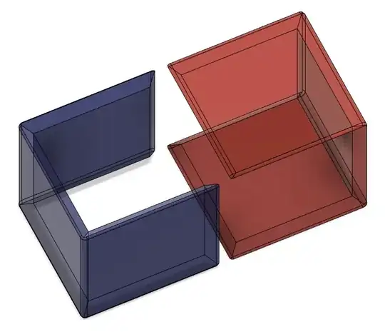

"simple" hollow cube from 2 C-clamps
This is a simple object generated by a mere extrusion, rounding corners, extruding again and a sweep, then copying the item and moving it into position.

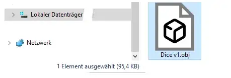

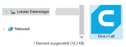

The STL is 74.3 kB, STEP is 90 kB, OBJ is 95.4 kB.
STL

OBJ
