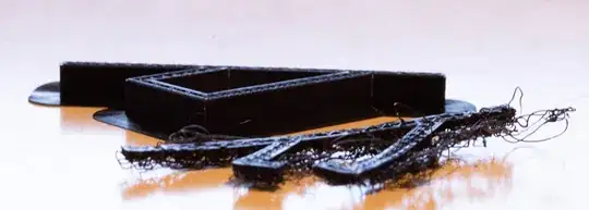

Yesterday that same part failed after 4 hours. I had to stop the print because the printer was making "a hairy mess" around the object.
Second try
As you can see there was some under extrusion earlier in the print which I didn't notice at first. I thought the part came loose since it had little to none adhesion to the bed and after cleaning the bed properly and using some glue I started the print again. The result was the same, this time the print failed a bit earlier.

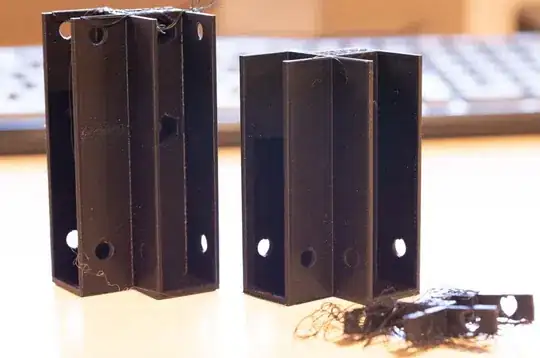

Second and third
(The small part was printed on top of the loose mess before it failed completly)
This time the bottom was quite loose again. After that I decided to print some smaller parts and do some troubleshooting first. I noticed some weird looking "curly" lines right away and stopped the print. It looked like "under extrusion" and a "not properly leveled bed". (Notice that didn't happen in the prints before). So, after leveling the bed and printing the small part again the part got printed well until the top 3 layers which looked under extruded again and I could see the infill pattern through them.

This time not quite as tall at the ones before and it failed again. The first hour or so everything looked fine, but the printer was getting quite noisy, every retraction was a very loud clicking sound the printer itself was shaking quite a bit during movement and the print failed again. This time the object was very firmly on the bed and I had to use some force to get it off.
fourth
The noise and shaking made me check the axis and tightened the wheels a little bit and after that I cleaned the nozzle with a "cold pull". The last thing I did was printing a temperature tower which failed in the same way and looks quite bad overall.

Please note that it seems that the filament curls up at the tip of the nozzle randomly, resulting in a few lines not getting placed properly on the already printed parts. Eventuelly the print then fails. When I push filament throught it curls up and the stream is relatively thin. Not always though, most of the time it looks fine maybe a bit thin. Can that be a clogged nozzle if X layers get printed ok, then for 5 seconds it messes up and then prints okay again?

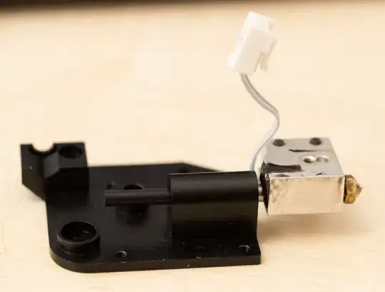

After I finally had the time to disassemble the extruder and I found a possible culprit - which did solve the issue for some time.
As you can see on the pictures the heater block leaked and this lead to some filament dripping off of the side and onto the print. The nozzle then eventually caught these drips and this caused the mess.
Here are some tipps for beginners like me:
  1. How to disassemble the extruder on the Sidewinder X1
  2. Be carefull when trying to screw the nozzle out. You will most likely need some heat to soften up / melt the filament. I was not carefull and broke the thread. I then had to replace the whole heatblock.
  3. Examine the tubing that leads the filament through the heatbreak and to the thread of the nozzle mine was a little bit deformed and didn't seem to be cut off straight to begin with.It has to be as flat as possible against the nozzle thread!
This was most likely the problem, Over time and after several melting ,hardening and melting procedures some filament creeped between the threads and the heatblock started to leak .. first slowly then worse and worse.
Hope that helps anyone. My prints come out great again. Plus I now know a lot more about my printer .
