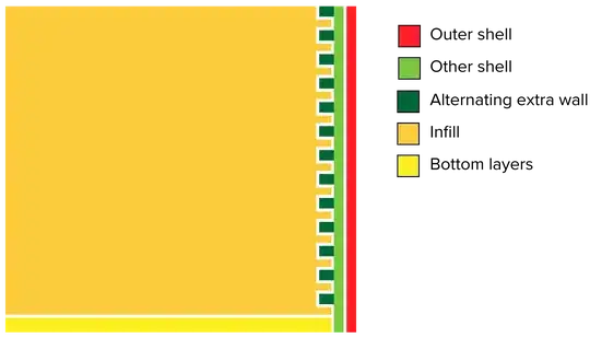

It is possible to get an alternate extra wall in Ultimaker Cura, the option is called Alternate extra wall. It can be used to catch the infill more firmly, strengthening the print.
From Ultimaker support:
This setting adds an extra wall every other layer. This way the infill gets caught between the walls, resulting in stronger prints. For example, if you set the wall line count to two walls and enable alternate extra wall, it will print two walls on even numbered layers and three walls on odd numbered layers. cross section schematics of a print
I've used this option frequently, but I'm not aware of any option that you can change the amount of layers alternating. You can do that probably with the option to set different options for different sections of the model, see e.g. "Different infill in the same part".
