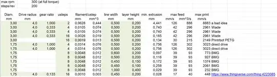

Your calculations about the theoretical extruder resolution are spot on. I did a similar calculation to evaluate which extruder to use with different hot ends, I paste the results. The dark cells are the input cells, the rest is calculated. You can see that for some lines I entered directly the mm/microstep value, since I wanted not a theoretical but practical result for my printer (3 mm filament) or for known extruders (BMG).

This is why I placed the usteps column in my calculations: it is meant to calculate a more realistic resolution assuming that no accurate microstepping is achieved. I assumed higher achievable microsteps the lower the load on the motor is (this means gears, or thinner filament).
