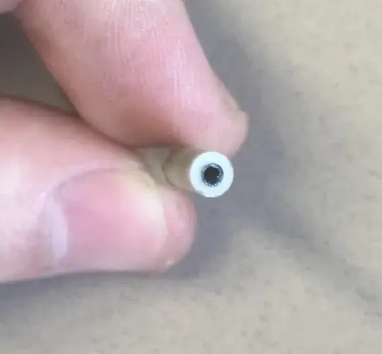

After disassembling the extruder mechanism, I tracked the issue down to a clogged extruder… though not in the way I'd expected. A (previously?) common method to drop filament down to the hot end and create a heat-break between the heater and the extruder gear was the use of a PTFE (Teflon) sleeve. Over time, this sleeve can become clogged by filament that has melted and degraded/carbonized, sticking to the "nonstick" walls. This creates a bottleneck for the new filament, preventing smooth extrusion.
Carbonized filament clogging tube. Location of heat-break on used tube.
My printer came with two replacement tubes. Swapping those in for the old, clogged tubes resulted in instantly improved printing… sorta like getting a new printer! Print temperatures are back to normal and everything operates fine. I was also able to drill out the carbonized filament from the old sleeve, though I doubt I'll reuse it. I found replacement sleeves on Amazon here and an alternative, all-metal extruder assembly manufactured by Micro-Swiss. I'm not sure if you'd run into clogging issues on the all-metal one, so perhaps staying with the PTFE tubes and replacing them occasionally is a better way to go.
