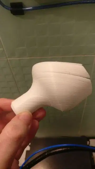

I woke up this morning with my 20 hour long print failed around 15 hour in. I checked the octoprint console, and saw a very weird temperature graph. Later found out thermal runaway protection kicked in, and I thanked the gods for having decided to install a custom firmware to enable that protection.
I have an anycubic i3 mega, recently upgraded with an E3D v6. To make that upgrade, I had to splice new connectors on both the thermistor and the cartridge, as the ones they came with weren't going to work.
Ever since upgrading I started experiencing some weird Z-wobble, but I am coming to the conclusion that it may actually be a slight consistent underextrusion. The final layers of the parts I had been printing, are all severely underextruded, going as far as delaminating. I have attached both a picture of the temperature reading, and one of the failed parts. You should also see the underextrusion I was talking about in the first layers, and the major underextrusion in the final layers.
Now, I don't have a lot of experience with this kind of issue but I think the temperature was jumping around too quickly to actually be a good reading. Sadly I was only able to take the final part of the graph before the printer shut down.

Do you have any advice for me? And if you could also help me figure out if the first layers actually show underextrusion or Z-wobble, thanks for making it this far.
I should mention that this had happened to me already but without triggering the protection, the part did heavily underextrude but it was just a test part while trying to find out what was going on with the "Z-wobble." It doesn't seem to consistently happen every time I start a print, but I figure that long prints would certainly make it more likely to happen.

  • Okay, thanks for the insight. i did assume something like that, I reseated it and for now it's been going okay. You'll hear back from me pretty soon if it's not fixed. In regards to that weird Z-wobble that I'm seeing, can you recognize any particular signs that can point me in the right direction? I'm thinking I'm actually underextruding as I had to set my flow multiplier to 105%, while before the new hotend I had it at 95%. – Guido Belluomo Dec 16 '19 at 00:58
Periodic temperature irregularities, such as cycling between a higher temperature and lower temperature slowly enough that it spends at least a layer or two at a different temperature than other layers has a tendency to be mistaken for z wobble. You can actually intentionally modulate print temperature (at least of PLA) every few layers to great a sort of banding or 'wood grain' effect. Higher temperature, for whatever reason, results in thicker perimeters and cooler temperatures thinner ones. This is when always staying above the normal PLA print temperature though. The temperatures in the graph would certainly cause serious under extrusion during the times it was under temperature.
Understand though, it is likely that temperature has been behind the underextrusion, rather than it being a problem in of itself.

Based on your symptoms, the thermistor reading looks to be quite accurate. What you describe is exactly what I'd expect would happen for a print where the temperature of the hotend really did vary exactly as shown in your graph.
What can often happen is one of the leads (especially close to the cartridge but really, it could happen anywhere along the length of the two leads) will have broken from repeated wire strain (if you have disassembled your hot end at all or otherwise disturbed the heater wires in anyway, this is more than enough to cause a lot of metal fatigue), but the insulation around the broken wire will hold it together such that wire will still be making contact with itself. But it will be a more resistive connection, and will cycle between an acceptable and poor connection as the print head position moves.
Long story short, you get a temperature graph that looks just like that, because the heater cartridge is periodically either developing a poor connection, or losing its connection entirely, only to regain it again as things move just the right way again.
I would double check all your connections to the cartridge, checking the actual resistance and not just using a continuity tester. If those seem ok, then you will probably just need to buy a replacement cartridge. I like to keep a few of them on hand since they have a tendency for their wires to break just from a little bit of normal manhandling.
