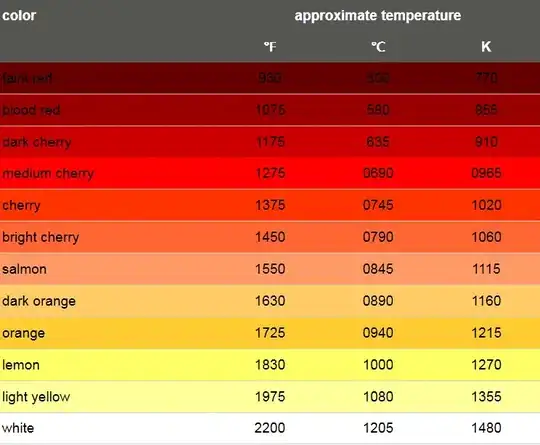

If my thermistor/heatrod slips off, my heatrod will glow into an orange temperature during thermal runway. This only happens briefly, but its color indicates it is reaching a temperature around 790 °C.
So, are silicone socks safe? Couldn't they ignite fairly easily?
Incandescence chart for iron

    note that your Incandescence chart is technically the iron one, the one for aluminum is a little different (by a margin of some hundred degrees). Note that Aluminium (which your heater block is made of) melts at 660 °C, so your most worrying item should be the block, which will melt, drip and melt anything below if this goes on for a couple seconds like seen [here](https://www.youtube.com/watch?v=qVjWg2vuWzk) – Trish Nov 19 '19 at 10:23
