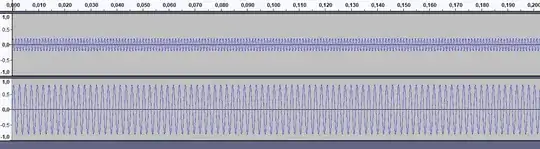

Let's take a simple example: a 440 Hz tune is generally considered to be the A4, aka concert pitch a or A440.
It could be encoded in a various ways. The probably oldest is to encode it as a note in violin notation, which then could be reproduced by anyone using a properly tuned instrument. The actual result depends on the instrument used as much as on the skill of the player. Each instrument thus might decode this encoded note differently, based on the physical setup of the instrument. Each instrument automatically creates the appropriate overtones.
A440 encoded as a note
In Midi, it is encoded as Note 69 and any machine that can decode a midi file could use this instruction, paired with an instrument to use, to create the A4 that is set for it. In Midi, the mere instruction of Note 69 does cut out skill, but how it sounds and feels comes from the instrument setup - which contains information about what overtones are to be created when playing this note.
For a physicist, the pure sound is encoded as just the notion of 440 Hz and some amplitude to balance how loud it is. With those instructions, he'd be able to set up a device that has these creates a 440 Hz tune. To generate the sound and feel of an instrument, the encoding for a physicist would need to contain all the overtones that are to swing with this one sound.
880 Hz overtone at 0.2 Amplitude and 440 Hz tone at 0.8 Amplitude
