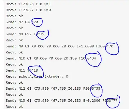

The G-code sent from Octopi to my printer gets multiplied at the end of every row. The corresponding code out of Simplify3D do not have that multiplication.
This results in a always Max speed print.

    Welcome to 3dPrinting.SE! According to [this answer](https://3dprinting.stackexchange.com/q/3118/11242), the asterisks at the end followed by a number is just a checksum, used to ensure what's going out is what's coming in ... this should have absolutely no affect on how your printer behaves. – Pᴀᴜʟsᴛᴇʀ2 Sep 22 '19 at 14:12
  • Thank you @PAULSTER2. And I though i searched the web :). Then I'll have to find my problem with the printer not reduceding the speed at for example first layer. – Ljung Sep 22 '19 at 16:40
I believe that everything after the "*" is a comment. From the random variation, I speculate that the comments for Octoprint are a check code. For other host programs, it is a sequence number.
@oscar linked to a previous answer in a comment which shows that it is a checksum. I will need to check the next time I run Repetier Host, but that seemed to be a sequence number. Please see Oscar's comment (and upvote it).

    Please look into [What is the purpose of asterix (\*) in Gcode?](https://3dprinting.stackexchange.com/questions/3118/what-is-the-purpose-of-asterix-in-gcode) to read about the asterisk character in a G-code. – 0scar Sep 22 '19 at 21:28
