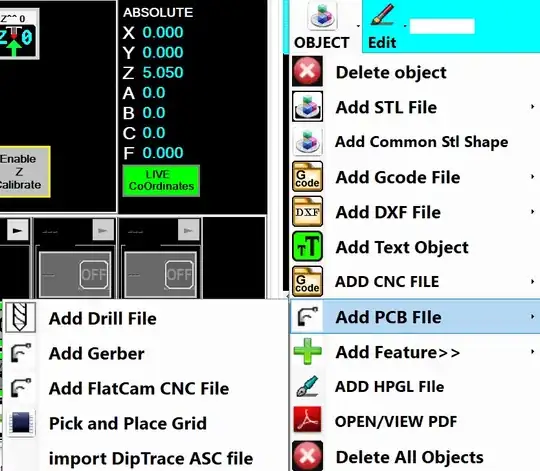

You can use both .gcode and .gbr files one one machine. We do it where I work.
However, when we make prototype circuit boards, we don't print them; we acquire circuit board blanks, and then we either:
Use a diode laser to burn off the top layer of garolite for isolation traces, then do a chemical dip to remove that copper, then another laser burn to expose pads for surface mount components; or
Use a spindle tool to remove the top layer of garolite where needed for pads, as well as mill through the copper layer for isolation traces.
We have not found a printable material that has the conductivity we want in a circuit board.
Source: I work for Hyrel 3D
Note: we don't use Marlin on Arduino, we use in-house firmware on STM32F429 boards.

Would that mean I can load .gbr files just like I would .gcode files with no extra configuring? Also, I'm planning to just use a spindle, no laser or chemicals. – ChocolateOverflow Jul 16 '19 at 12:37
What does your software and firmware work with? Our software and firmware can do this. [See this image](http://hyrel3d.net/images/repetrel/rep_obj_menu.png) (also added to answer). We also make our own solder paste masks (from aluminum cans), and use our pick-and-place attachment to position surface-mount components, then put them in our reflow oven to make prototypes and first runs, before sending them out for mass production. – Davo Jul 16 '19 at 12:48
I'm using the Marlin firmware for my machine and I'm not sure it can use .gbr files. My machine is just supposed to etch prototype boards and 3D print. – ChocolateOverflow Jul 16 '19 at 13:47
As noted above, we don't use Marlin on Arduino. We use in-house firmware on STM32F429 boards. I don't know what your setup is capable of, but it does not seem like a very big stretch to turn a different motor during "extrusion" moves. – Davo Jul 16 '19 at 13:55
I asked about using Marlin on Arduino so your answer didn't really answer my question. – ChocolateOverflow Jul 17 '19 at 02:40
That's true - so please do not accept it. But other users may see your title, which is more general (and which this does answer), and find this answer useful to them. – Davo Jul 17 '19 at 11:09
