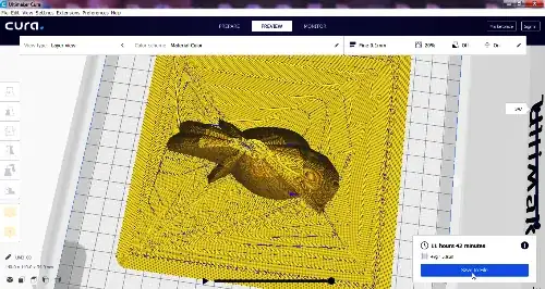

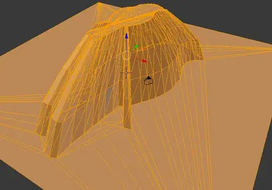

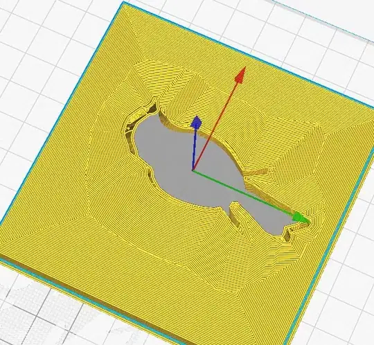

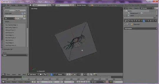

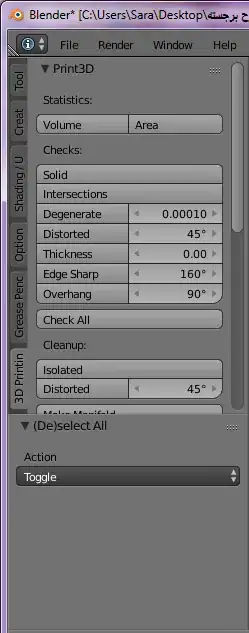

I'm new to 3D printing. I modeled an empty bird in Blender (the stl file of model is presented). I tested the model in Blender (using 3D printing tool) and also the Netfabb software. They don't show any error. However, when I load this model in Ultimaker Cura for printing, as shown in the last image, the result is only a cylinder shape bird. I have seen many 3D printed empty models on internet. Why can't my model be printed correctly? the download link of the model

  • I named the model empty because i didnt close the bottom of the object. I would like to use the printed object as a mold. Therefore the bottom of the model should not be closed. – sara Jul 01 '19 at 19:15

  • Thank you. I have seen this problem. Sometimes the ultimaker cura can slice the model incorrect as shown in figures. But most of the times it is considered as an invalid model in cura and can not be sliced. I used netfabb to repair stl file. It shows the file as a valid stl file. However it can not be printed using cura. I think this a simple model and i cant realize what is the problem. – sara Jul 02 '19 at 07:23
You have modeled your bird. So far so good, but you likely only modeled a single surface and not a closed surface body. The crucial step was forgotten, as your pictures 1 and 2 show: you have designed a single surface for most of the object, not a body. To turn the bird into a printable object needs it not to be a single surface but a surface enclosing a volume that has some thickness.
At the moment, it looks like this: 640 vertices, NO enclosed space.
Model as shared

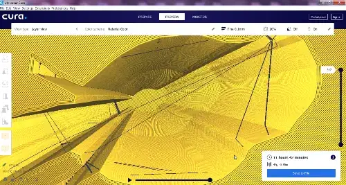

after a lot of search, i used the autodesk Meshmixer to add thickness to the model. I used the blender only for modeling and didn't use the solidify modifier to add thickness to the model. Then in autodesk Meshmixer, using select→ edit → Extrude, i added thickness to the model (the new stl file is presented). It seems that the new model can be printed. However, the blue lines can be seen in the print preview of Ultimaker Cura and i dont know how to remove them. Unfortunately, i haven't a 3d printer to test the model, but it seems that it is printable. the link of repaired stl file
repaired model in cura
the bottom of the repaired model in print preview of cura

    The blue lines are moves, there is a tiny gap at the tail end though (the same area I had without throwing a fix over the top part), otherwise, it's a good and working fix. Good job finding a way that works for you! – Trish Jul 06 '19 at 09:53
