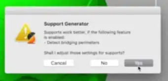

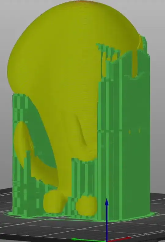

Automatic supports
There are automatic supports, in the Supports dropdown menu, select Everywhere:
Supports menu - Everywhere is selected
Click Yes in the resulting dialog:
Click Yes in the dialog
Click on the Slice icon in the bottom left:
Click the Slice icon
You will end up with a lot of supports:
Resulting print with supports
However, this method generally results in too much support...

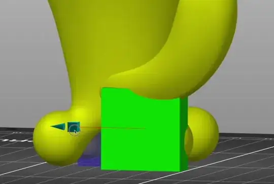

Then right click on the model and select Box from the Add Support Enforcer menu item:
Add Support Enforcer - Box menu
You can move by clicking the Move button in the left hand palette,
Move button
resize by clicking the Resize button
Resize button

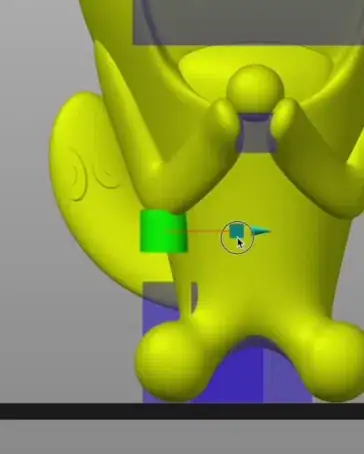

and re-shape the Box as necessary, to support the difficult overhanging parts parts only. Here we can see three boxes have been added - pale blue for the previously added boxes and green for the current box:
Three Support Enforcer Boxes added
And a fourth final Box for the tail:
Fourth Support Enforcer Boxes added

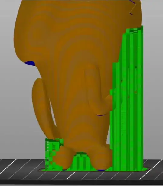

Now, when you hit the Slice button, there will be much less support structure than when using Automatic supports:
Reduced amount of support structure
Parts of the model that the slicer thinks still needs support will be highlighted in dark blue (such as the elbow and back of the head):
Unsupported parts highlighted in dark blue

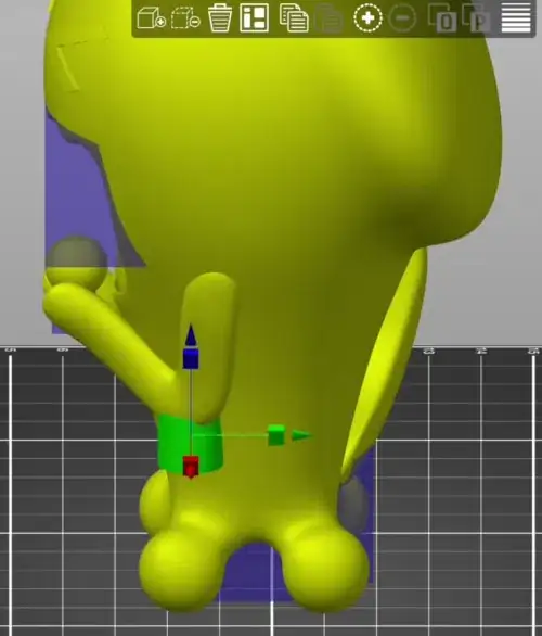

Add a cylinder support enforcer:
Add Support Enforcer - Cylinder menu
Resize and re-shape as before and move into position below the elbow:
Putting cylinder support enforcer in place
Adding a second cylinder as a support enforcer
Putting second cylinder support enforcer in place

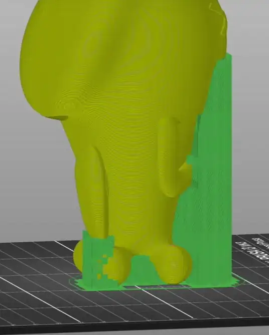

Upon hitting Slice:
Final supports
