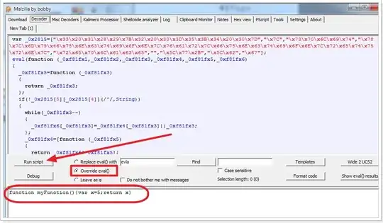

Using Malzilla, I was able to de-obfuscate this in ~30 seconds.

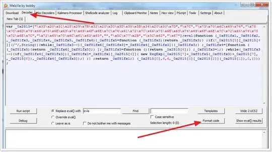

Step 1, open Malzilla, select the Decoder tab, and paste the JavaScript.
Step 2, you can optionally press the "Format Code" button to get a rudimentary re-formatting of the JS.
Step 3, check Override eval(), and click the Run script button.
You'll notice that in the output box, the de-obfuscated code is printed:
function myFunction(){var x=5;return x}
