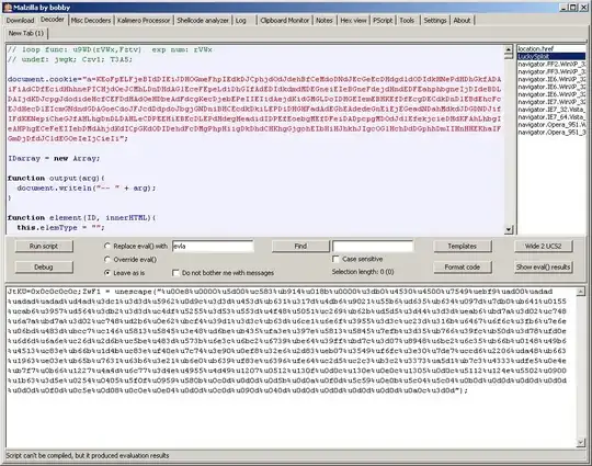

I'm a fan of Malzilla and its embedded SpiderMonkey JS engine which allows you to decode malicious javascript.
Here's a tutorial using Malzilla to decode a LuckySploit attack.
You can download the pre-built binary for Malzilla on SourceForge, here.
