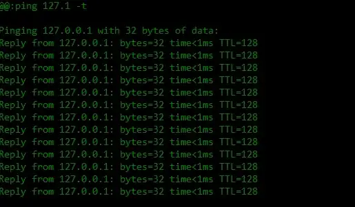

ping 127.0.0.1
ping response for 127.0.0.1

i always wonder where upto it goes while doing pinging 127.0.0.0 and 0.0.0.0 but i've idea about it check working of TCP/IP suits while pinging 127.0.0.0
    127.0.0.0/8 it's a reserved network for local connections, and simply means that any address from that network - it's your device. 0.0.0.0 is a reserved address that means "any host", so you can't directly ping it, but it's often used in access-lists to specify "any address". – Andrey Prokhorov Jan 29 '19 at 12:17
By design, the 127.0.0.0/8 network is supposed to respond even when there's no network adapter in the machine.
When you ping an address in this network, it doesn't goes down to the hardware layer, not even to the L2. The request is handled and responded to in the Internet (Network) layer of the TCP/IP stack.
So you cannot capture it on any other adapter than the loopback adapter(except maybe if you configure a port mirroring of the loopback adapter to another NIC or other unusal setup of packet forwarding).
