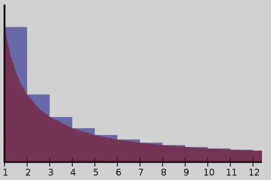

Hint: The sum on the right is equivalent to an LRAM approximation with $\Delta x = 1$ of $\int_1^n \frac{1}{x} dx$. Since $\frac{1}{x}$ is decreasing, LRAM over-estimates.
If you didn't know, LRAM = Left Rectangle Approximation Method. To estimate the area of a function $f(x)$ from $1$ to $n$ with $\Delta x = c$, we find $c(f(1) + f(1+c) + f(1+2c) + \dots + f(n-c))$
Here's a handy visual, taken from the wikipedia page for the Euler-Mascheroni constant
Visual
(How do I incorporate this directly in my post?)
