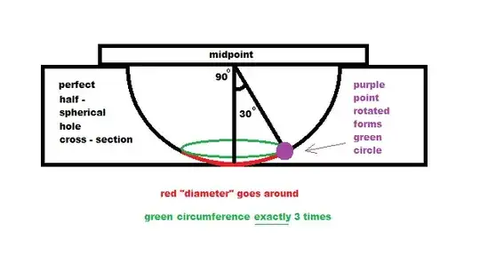

If you have a diameter that's allowed to be non-flat then you can extend it to go around a circle fewer times than three. And you can construct non-flat spaces where this can happen.
For instance, if you dig a half-spherical hole in the ground, put a plank across the center of the hole you dug, and drop a plumb line straight into the center, and rotate a stick that's angled 30 degrees off of this plumb line to draw a circle in the hole - that circle will have a diameter in this 2-D half-spherical space that will go around the circumference exactly three times.
