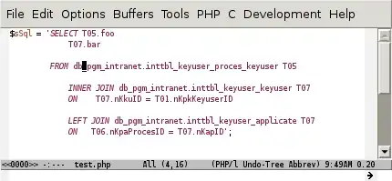

I have another syntax highlighting for SQL keywords inside strings (inside quotes) in VIM. It looks like this:
Then in Emacs with PHP-mode, everything between quotes (') will be considered as a string by the font lock:
As you can see, the first example with another font face properties (no cursive keywords) is more clear. The keywords are much easier to distinct.

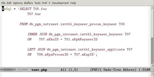

And here a picture of the text as it looks like when I load it into emacs with PHP mode:
Picture of the php file with italic keywords in sql strings
With display class color strings are not italic but have a different color. Therefore, I have chosen italic font face for SQL keywords within strings.
