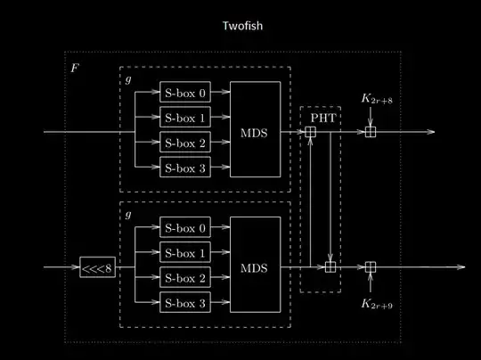

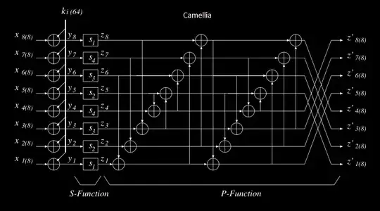

Camellia uses each s-box twice per round, and runs the entire 64-bit input through those s-boxes in parallel, then mixes them together. Key material is added to the input prior to the s-boxes. Twofish uses each s-box twice per round in parallel, then mixes each 32-bit half, then mixes those halves together, followed by addition of key material.

Camellia F-function Twofish F-function

Camellia uses 4 AES-like s-boxes (finite field inversion), S2 S3 and S4 are generated from S1, which has a base design optimized for minimum hardware resources. A time-memory tradeoff can be made in implementations where only the table of S1 is in memory, and the permutation to the other s-boxes is done at runtime, which is composed of fixed rotations. Minimal hardware resources and a Feistel design (same decrypt hardware, less data processed per round) can make Camellia more efficient than AES in dedicated hardware. The key schedule is more complex than AES, and it reuses the round function to generate key material.
Twofish s-boxes are made from 2 different permutations and key material. The permutations themselves are made from 4 fixed 4-bit s-boxes each. A time-memory -storage tradeoff can be made in implementations where only the tables of 4-bit s-boxes are stored in code, and the permutations are generated and stored in memory during key scheduling, where the s-boxes are generated. Twofish has a much more complex and expensive key schedule by design.
