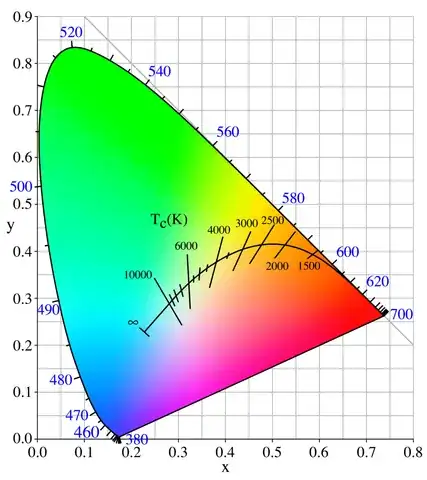

Human color vision is based on three types of "cones" in the eye that respond differently to different wavelengths of light. Thus, not counting overall brightness, the human color space has two degrees of freedom. In contrast, the spectra of stars are very close to a black body, which depends only on effective temperature. As one varies the temperature, the color of a star should make a one-dimensional curve in this color space. Thus, unless some perverse shenanigans are going on, it is intuitive that we necessarily miss most of colors, i.e. there will be no stars of those colors.
Our Sun actually has a peak at about $500\,\mathrm{nm}$, which is a green. However, that's just the peak: since the Sun also radiates lots of light with shorter wavelength (bluer) and also longer wavelengths (redder), the resulting mixture doesn't look green to human eyes.
An image from wikipedia on the color of a blackbody of a given temperature:
Color temperature
Note that the colors at near edges of this color space aren't accurate, because the sRGB standard used in computers only covers a fairly small triangle portion of it. Still, that's a complication that's not very important here.

    Does this mean that a green star is literally impossible? – HyperLuminal Apr 19 '15 at 12:59
    @HyperLuminal It means that a green blackbody is literally impossible, and since the spectra of stars is that of a blackbody plus some relatively spectral line corrections, green stars should be impossible too. I'm not entirely sure how to quantify a deviation from greenness, though. In any case, you can see from the color space that there's nothing special about green in this way, as you stars actually miss almost all the colors. – Stan Liou Apr 19 '15 at 14:12
    Your argument of a curve in a two dimensional space is beautifully clear. I subscribed for the very purpose of voting this up! – Michaël Le Barbier Apr 19 '15 at 14:43
  • It would be interesting to add the curve of pure frequencies to this diagram. – Steve Linton Sep 01 '20 at 07:15
