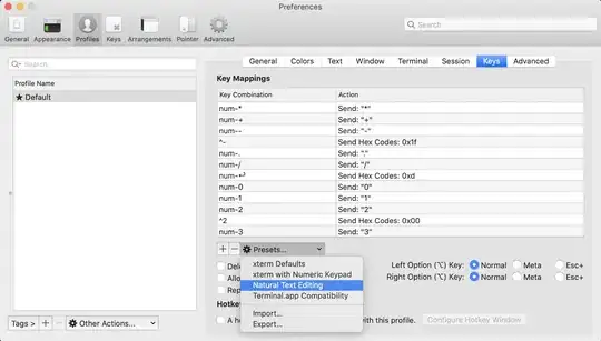

  1. Go to iTerm2 (in the menu bar) > Settings... > Profiles > Keys (not "Preferences... > Keys"!),
  2. On current versions (since version 3.4.9): switch to the Key Mappings tab,
  3. Press Presets... dropdown button,
  4. Select Natural Text Editing.
screenshot of dialog with Presets

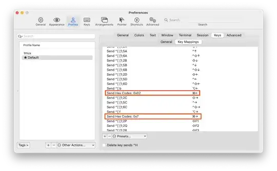

    This is great and will add most of your needs. It however does not add a 'go to start/end of line via CMD + left arrow/right arrow`. For that action, see: https://stackoverflow.com/questions/6205157/iterm-2-how-to-set-keyboard-shortcuts-to-jump-to-beginning-end-of-line – MikeyN0 Oct 03 '18 at 23:07
  • Only issue is that say you have to ssh into a remote box, you need to know the standard terminal shortcuts. I just discovered this was possible now and was like "whoa why have I been twisting my fingers into ctrl+w to backspace a word, but on second thought, maybe its good to keep the muscle memory of the standard ones. – vaughan Oct 31 '19 at 20:12
  • this is a better answer but i got a side effect: now CMD+arrow-key moves the cursor to the start/end of line (similar to Option + arrow-key) instead of navigating between iterm tabs. – Lafi Apr 08 '20 at 15:28

    With the new versions you'll need to go to Key Mappings then select a preset. You could also use Terminal.app Compatibility which gives the same result. – Ibrahim.H Sep 23 '21 at 08:19

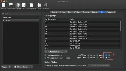

With iTerm2 3.1.4, I was able to setup the following without adding individual key mappings.
  1. Go to Preferences > Profiles > Keys
  2. Left/Right ⌥ Key: Select Esc+
With a new Terminal session you are now able to use:
Option ⌥ + f to Get Forward
Option ⌥ + b to Get Forward
Option ⌥ + Delete ⌫ to Delete Word
