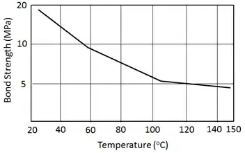

However, not all glues get stronger with temperature! PVA (also called PVAc) glues soften very quickly, making them good only at low temperature. See "Influence of temperature on the strength of bonded joints" which discloses this graph for PVAc Rhenocoll 3W, 4B Plus:
